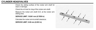

In my 2021 service manual the "standard" compression is 261 psi (1800 kPa) @ 470 rpm with throttle fully opened.
The only suggested cause for high compression is carbon deposits in the combustion chamber or on piston head.
If your compression was too high, I would expect you would have detonation or 'pinging' especially under load.

Hi everyone, good news! Problem not solved yet, but at least found: it seems there was a material or heat treatment fault in my camshaft, there was a small crack in one of the lobes (correct term?) which couldn't be seen at first (I needed a magnifying glass to see it and it could be felt by a fingertip), but it started to wear out the rocker roller (not sure on the correct term on this either), and it must've hit it more that it was supposed to and the roller started to "stick". That was causing the hard start, as it tried to push the rocker and the valve, it acted as a brake on the camshaft (while also starting to wear out the camshaft lobe itself). The camshaft and the rocker is toast anyway, we grinded it a little with Dremel to get rid of the fault line and voila! starts as new. While the engine was running, it didn't cause any symptom, no sound, no vibration or anything, and the engine easily overcame of the resistance it seems, but it was a bit too much for the starter.
So I'll need a new camshaft and a rocker (and maybe I'll replace the chain and the tensioner, as it seems this whole thing caused the chain to wear out sooner, as there seems a little low reserve left in the tensioner)
Thanks for all the input for everyone, the thread can be closed.

...there was a material or heat treatment fault in my camshaft, there was a small crack in one of the lobes (correct term?) which couldn't be seen at first (I needed a magnifying glass to see it and it could be felt by a fingertip), but it started to wear out the rocker roller ...
I think the reason is the opposite. As the valve rocker arm roller has stopped rotating, it has damaged the cam surface.
Yeah, it's likely, that would be my first guess as well, but I thought the camshaft had been the cause because of the crack-like nature of the fault. A stuck roller would wear out the lobe, not crack it (one would think). Anyway, I suspect it must've been a material fault, not a machining one, I owned Hondas before, and a lot of my friends did and do, haven't heard about a similar kind of fault ever. I guess it's a one in a million thing, maybe I should buy a lottery ticket. :) If not for the worn lobe, it would be enough to replace the rocker. But seeing the surface hardening being damaged, I'll opt for replacing the whole thing (with the chain and the tensioner).
