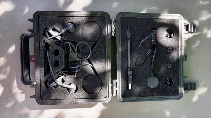

Close up shot of iASUS Stealth Throat microphone carrying case

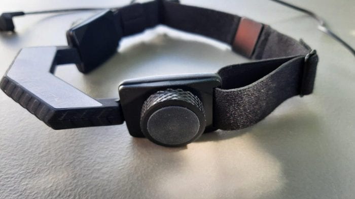

The IASUS Stealth Throat Microphone Headset System featuring Bluetooth 5.0 BLE is a new product in pre-release from a company that continues to set the standards for throat microphone performance and customization.
It is arguably the industry’s first completely wireless modular system making it suitable and adaptable for an even wider range of professional and personal applications than anything before or currently on the market.
Over the years wBW has followed with interest the audio offerings from IASUS, like the IASUS Diablo Mobile Amp, the IASUS EAR3 Amplifier, or the original and superb IASUS XSound3 Speakers, along with other products adaptable to motorcycle use, including IASUS Throat Microphone products that I have used extensively over many years.
Based on BT 5.0 with BLE, the Stealth product is a wireless interface that when used with one of its audio output options (acoustic coil, noise isolation earbuds, helmet speakers, or headset) and paired to a BT equipped smart device becomes a versatile body-worn personal communications capability – work or leisure focused.
It is uniquely styled and functions like a hand-crafted piece, attributes synonymous to IASUS, while providing a rugged (IP66 Ingress Protected rated) and versatile solution to a host of communication-based requirements.

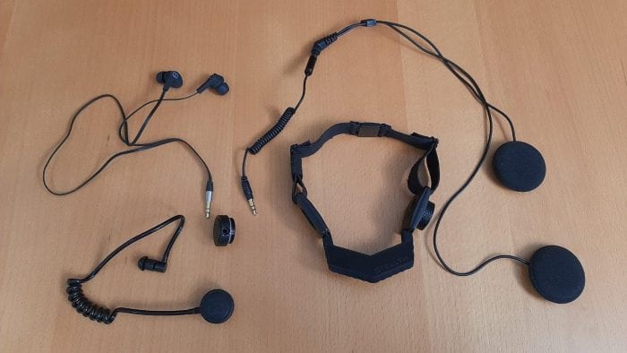

Stealth System Features & Specs​
Compilation Listing
  • First true wireless throat microphone headset available
  • Modular and customizable for virtually any communication situation
  • Uses Bluetooth 5.0 with Bluetooth Low Energy (BLE)
  • Multipoint BT pairing for primary/secondary device connectivity
  • Supported BT Profiles are AVRCP, A2DP, HFP, HSP, SPP, and BLE
  • When paired with smart devices, Stealth offers a multitude of functions and features including basic communication, PTT, audio playback, etc.
  • Digital Assistant/Voice Command interaction (if enabled on the smart device)

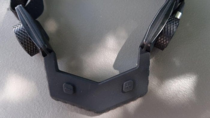

  • Single primary input control and two smaller easily accessed controls
  • Gen 4.0 transponder with custom DSP software provides exceptional throat microphone clarity under all conditions
  • Transponder sensitivity of -46dB +/- 3dB
  • Audio amplification of 10dB boost with <0.3% harmonic distortion
  • Two audio output modules – low profile (covert) acoustic coil based or 3.5mm module for headphones, helmet speakers, headphones, earbuds, custom earpieces, etc.
  • New ergonomic design with revolutionary combination of materials
  • Flexible silicon aerodynamic wing blade design for a customized angle fit
  • Adjustable & removable neck strap with magnetic breakaway clasp
  • System provides sustained performance under protective gear and in extreme conditions
  • IP66 Ingress Protection Rated against dust and water
  • Silicon surrounding all essential ports restricts entry of dust and dirt
  • Battery: playback time of nine (9) hours, call time of ten (10) hours, standby time of 250 hours. 90-minute charging time at 5V, battery capacity is 1500mAh

Outside of installing the desired audio output option and doing an initial fitment check of the neck strap and positioning of the transponders, the initial action, before pairing the first device, is to make sure the battery is fully charged before use.

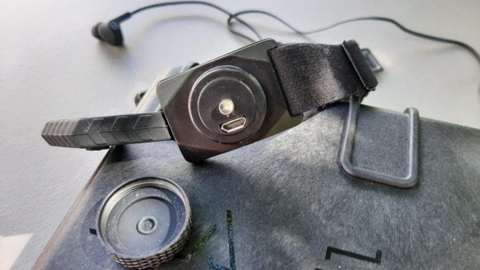

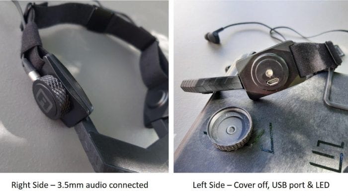

Charging​
The built-in Lithium-Ion battery is charged and ready for use when shipped. When charging is needed the included micro-USB cable is connected to the port – covered by the Primary Button Ring cover.
To access the charging port, turn the left side Primary Button Ring anti-clockwise, and remove the cover. During charging the LED remains Red, changing to Blue when fully charged.
Note – connect the micro-USB cable to a computer USB port only. Do not use a USB-C fast charge port or a direct AC/DC charger as these may/can charge more than the recommended 500mA maximum that might damage the Stealth’s charging mechanism.
And to maintain the performance of the battery, do not drain it and leave it sitting depleted for an extended period – the battery needs and likes to be exercised.

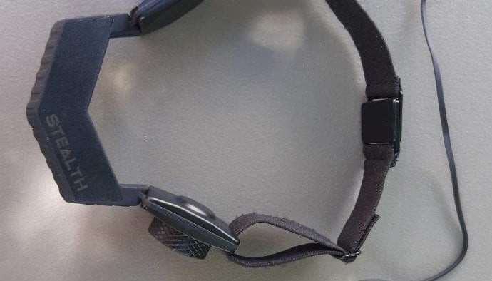

Close up of iASUS Stealth Throat microphone

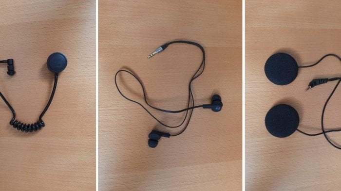

Audio Output Options​
The Stealth Throat Microphone provides two interchangeable thread-on modules for audio output. The first module has an acoustic flex coil and single mono earbud insert and four differently sized silicone cover sets for optimum ear fitment while the second (optional) module has a 3.5mm port for connecting helmet speakers, earbuds, or headsets.
To remove the installed right-side audio module, turn it anti-clockwise to unscrew and remove it, then seat the other module and turn it clockwise and tighten firmly until it will not turn any more (this ensures the silicone ring provides a waterproof seal and for pin contact alignment and orientation purposes the IASUS logo should be horizontal and right side up.
If using the (optional) 3.5mm module, be sure to fully insert the helmet speakers or earbud jack into the module until a distinct ‘click’ is heard, confirming that the waterproof seal has been established.
A small flat elastic loop beside the right transponder is used to route and secure the acoustic coil or the speaker lead for a cleaner less obtrusive feel and look.

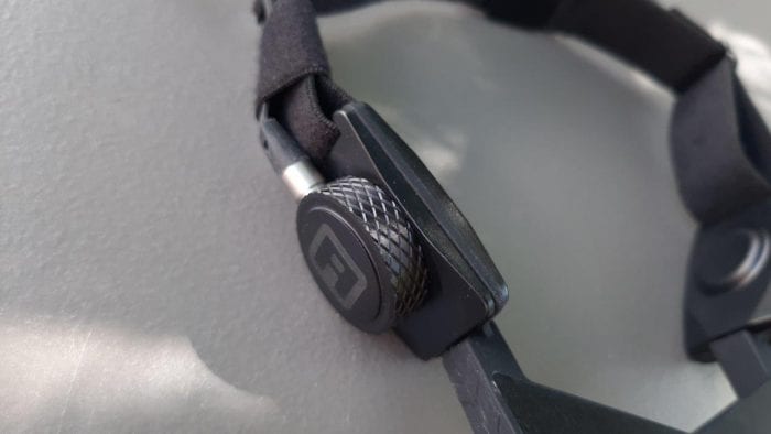

Neck Strap and Breakaway Clasp​
The soft elastic neck strap is very comfortable overall, although it is important to have it properly located on the neck and adjusted just right so that it sits and keeps the transponders in place without being uncomfortable over the longer term.
An adjuster on each side of the strap provides the means to easily adjust the overall diameter of the strap – this can be done with a bit of effort while being worn, but from experience, it is far better to have the needed adjustments made before putting the throat mike on and layering anything over it.
The Stealth neck strap is equipped with a magnetic breakaway clasp, providing rapid removal of the neck strap when required, especially in an emergency situation; the effort required to disengage the clasp is minimal – pulling firmly on either strap will separate the clasp.
In normal use, it is best to separate the two sections with a twisting motion, e.g. – left hand pushing down and right hand twisting up; it really does only take minimal force to separate.

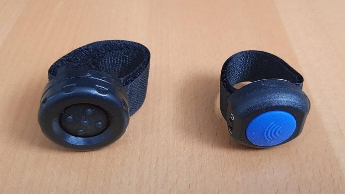

Primary Button Caps​
Included in the Stealth kit are two interchangeable left side Primary Button Caps, providing the means to alter the visibility or conspicuity of the indicator LED; the regular cap allows the LED to be seen, whereas the opaque cap blocks it for stealth mode.
Primary button caps on iASUS Stealth Throat microphone

Press and hold the left side Primary Button for two (2) seconds. To power Off, hold the + button until the Blue LED turns Red – the system then powers down.
Volume Control
For system volume control the plus (+) and minus (-) buttons are used for Volume Up and Volume Down respectively. A single quick press and release, and subsequent ‘beep’ confirms a discrete step or change in volume output.
Note – these controls do not provide continuous volume adjustment if held; using the Volume Up in this manner will turn the system off…

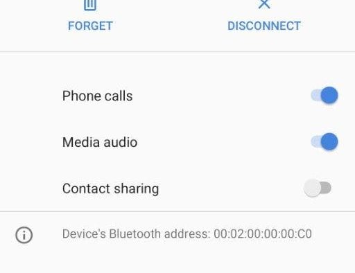

Bluetooth Device Pairing​
Press and hold the Primary Button for three to four (3 to 4) seconds until the LED flashes Red/Blue; an audible pairing tone is heard if output is connected. On the device being paired, look for and select the ‘Stealth BT5.0’ listing from the device’s BT listing.
Once paired and connected, a single beep should be heard from any connected audio output. A list of the available services (Phone, Audio, Contact List) should be identified under the connection profile on the paired device, allowing customization of services to be used.
Subsequent Device Pairing​
The Stealth supports the pairing of two BT devices at the same time, such as another smartphone/device, GPS, wireless music player, etc. Initiate pairing mode again and select ‘Stealth BT5.0’ from the second device’s pairing screen to complete the pairing and connection process.
In pairing a second device, the first paired device is disconnected – as expected. If the first device needs to be reconnected, use that device’s BT menu to manually select and reconnect to the Stealth.
An alternative approach, if viable depending on the smart device or devices paired, is to customize (select) the desired ‘available media services’ for the Stealth BT5.0 on each of the paired devices.
For example, if Device 1 is dedicated for phone calls and/or PTT-based services, then ‘Phone Calls’ and perhaps ‘Contact Sharing’ services are enabled on it, with Device 2 configured for ‘Media Audio’ only. Some newer devices running BT 4.2+ or BT 5.0 not only pair but, connect with two devices concurrently to facilitate active audio channel switching.
A big part of the modularity feature of the IASUS Stealth system is its support for a wide variety of personal audio output solutions. As such, using one of the IASUS options or another solution is made simple – a particularly valuable feature when appreciating the many applications that the Stealth system has.
IASUS Acoustic Coil Module​
This is classed as the ‘Situational Awareness’ earpiece in having a simple 3.5mm jack on one end, a coiled lead, and a single acoustic coil earbud – designed for the right side, but usable on either with some stretching. Other than a wireless in-ear piece, this approach is great where voice audio and a discrete stealthy look are primary.
IASUS Earbud Speaker Kit​
The iA Waterproof Earphones (short cord) are an NR earphone option for the Stealth and IASUS GP3 Headsets, providing a noise reduction of -25db and meeting the ear protection safety standard for general hearing safety applications. They come with earbud slip-ons in three sizes and provide great mono or stereo audio.
IASUS XSound3 Helmet Speakers​
IASUS marketed the first high fidelity audio drivers specific for helmet acoustic applications over 15 years ago and the latest iteration of the XSound3 high definition speakers provides even better helmet audio than the originals.

Bluetooth low energy buttons for pairing with iASUS Stealth Throat microphone

With the Stealth correctly oriented the volume controls on the wing are on the underside (Left = Minus, Right = Plus) with the Primary button/port cover on the left side of the strap and the Audio Output interface module on the right side.
Best positioning for a throat microphone is 2.54 to 3.8cm or 1 to 1.5in to the side of the voice box or larynx, a positioning facilitated by the design of the Stealth’s shaped angled ‘wing’ centre section and the lateral transponder housings. The wing provides aerodynamic shaping to cope with frontal air pressure and the optimally placed transponders provide the pick-up.
If new to throat microphones, you (and other participants) will find that overall pick-up and resultant transmitted speech is good, but not as crisp or rich tonally as when using a standard microphone and headset layout.
For consistent audio pick-up performance, it is important to keep the transponders resting comfortably on and in contact with the neck – without being overly constrictive. The adjustable straps provide the proper tension to maintain the Stealth and thus the transponders in position while still providing flexibility for continued comfort; do not overtighten the straps.
Something else that throat microphone users learn – to speak in a soft clear (calm) manner. Speaking loudly or yelling with lots of emotion tends to overwhelm the sensitive transponder microphones with resultant audio level clipping and loss of output.
But on the definite plus side the Stealth benefits from extensive IASUS in-house advancements that close the gap between traditional open microphone use and a throat microphone; in currently using three different brand throat microphones, the Stealth piece is the best, by far.
The stylized centre wing section is meant to provide aerodynamics as needed and an easy to find control surface, but the left side Volume Down and right side Volume Up controls, while easily located overall and readily actioned with the bare hand or with light to medium gloves worn can be hard to activate with heavy gloves.
And depending on the upper garment being worn, access to the centre wing and underneath controls can be further complicated, so it is essential to get the best response positioning vis-à-vis garment; all doable, but it just takes some familiarization.

A push-to-talk or PTT device of some sort remains one of the best means to positively switch between input and output (listening) for simplex communications. There are lots of options available – wired and wireless and as identified earlier, two compatible PoC PTT buttons are in use, although more mobile radio interface testing is ongoing…

In using as many different 3.5mm accessory helmet speaker sets or external headsets as possible, some real differences in audio output level and quality are noticeable, with most of the newer ‘HD’ focused helmet speakers a positive step forward for the user.
So far, three helmet speaker sets have been used with the Stealth Throat Microphone Headset system. These are the Cardo 45mm JBL Audio Speakers (now standard with the Cardo SE PACKTALK products) and two sets (original and latest) of the IASUS XSound3 speakers.
Even to these aging ears, all three provide great quality audio but, there are output differences across the frequency range (low, mid, and high frequency related) although little differences in volume levels.
I haven’t yet had a chance to try an accessory set of the new Sena HD speakers used with the Series 50 systems but some ongoing formal testing between available sets using the Sena 50R auxiliary audio input and the IASUS audio port is revealing some interesting differences between the different products; hopefully, a summary of sorts can be done in the future.

Where a simple in-ear piece suffices for basic communications the Acoustic coil does the trick discretely, as do the earbuds with the additional benefit of providing excellent stereo audio. But if HD high fidelity helmet audio is needed to round out the personal system audio experience the XSound 3 speaker option is the way to go.

And now that we have small mountable or wearable Bluetooth BLE enabled PTT/PoC devices to use that is compatible with the IASUS systems, smart devices, and many mobile radio products it would be great to get our BT-based helmet communication systems that so many of us use, to provide PTT/PoC support; first one to this gate gets my money…

  • BT 5.0 with BLE for functional efficiencies including long battery life

  • Covered micro-USB charging port
