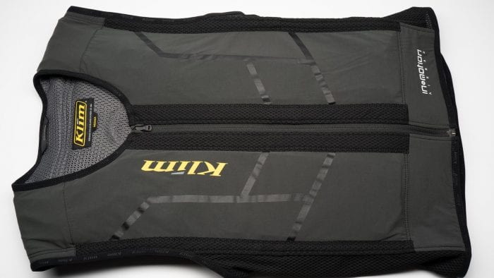

From the front, the Klim Ai-1 appears to be rather basic and unassuming with the dark gray color giving the vest a subdued look. The back is where the action is. A thin, perforated plastic shell gives the appearance of a technical piece of armor although it is really too thin to offer much protection itself.

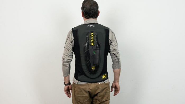

Rear view of where Klim Ai-1 electronic sensor attaches The back showing the space where the electronic sensor package is attached

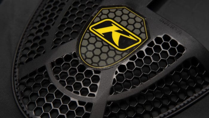

That’s OK because it’s what’s underneath that counts. The plastic shell is there to support the electronic sensor package for the vest. It’s attached to a large flap of nylon material that unzips to access the back protector and gas cartridge within.

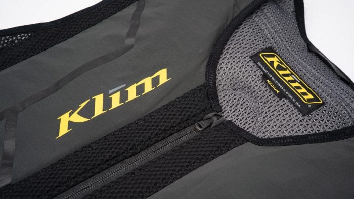

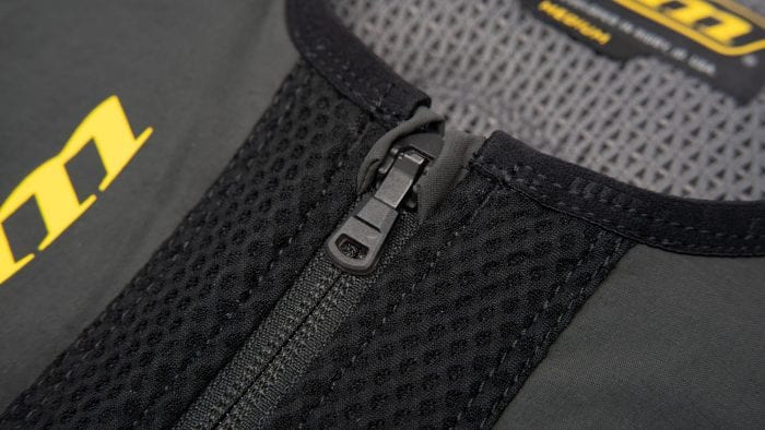

The main closure of the vest is a zipper that has one of the best features I’ve seen on a zippered jacket, vest, etc. The zipper pull is spring loaded so it remains flat against the vest once one lets go of it. It’s a small feature but I wish all riding gear zippers worked like this. I would point out that the zipper pull itself could be a little larger for easier use when wearing gloves.
Klim Ai-1 airbag vest spring loaded zipper Spring loaded zipper pull could be larger
On either side of the zipper is a one inch (24mm) strip of 3D mesh running the length of the zipper opening. More of this mesh surrounds the back panel as well around the internal protector. The sides of the vest employ a thin, stretch mesh that allows the vest to increase in size by additional six inches ( 15.25cm) with this size medium version. This works to help keep the vest close to the body while keeping it comfortable.

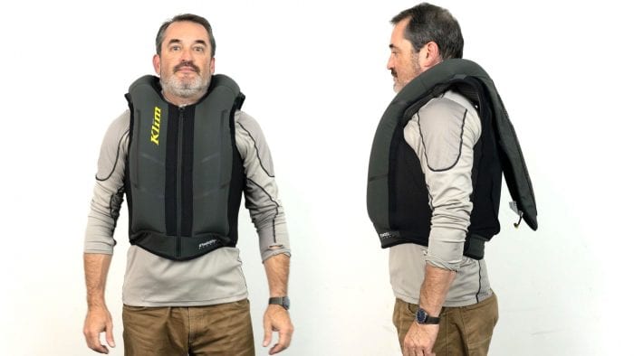

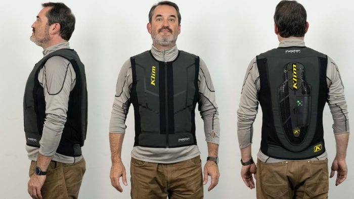

Front, side, and rear view of user wearing Klim Ai-1 airbag vest Three views of the Ai-1 vest
Klim branding is in place with a KLIM logo on the front and back in yellow while the back gets two additional “K”’s for good measure. In&Motion is also represented by a logo at the lower left front and one behind the neck. Of course with the vest designed to go under other apparel, so the branding is mostly moot.

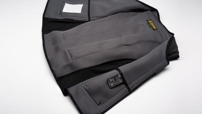

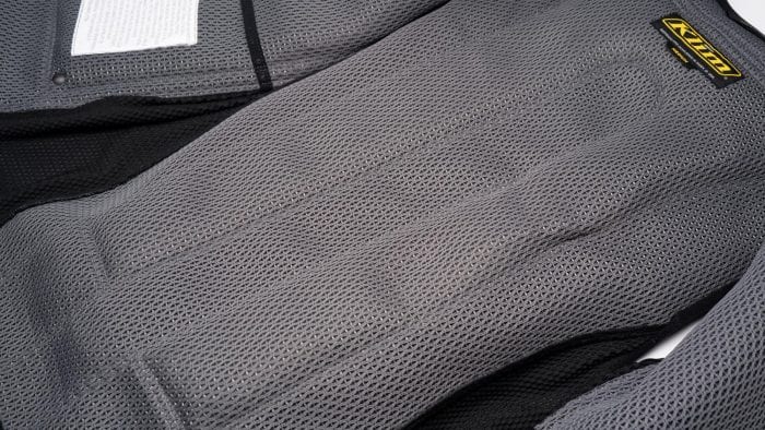

Mesh interior view of Klim Ai-1 airbag vest The interior is lined with a multi-layer (3D) mesh material
There are no storage pockets but there are openings on the inside of the front panels for inspecting the airbag. Looking at the inside of the back one can see the space where the rear portion of the airbag is located. The twin spaces sit on either side of the spine and run almost all the way down the back.

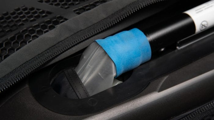

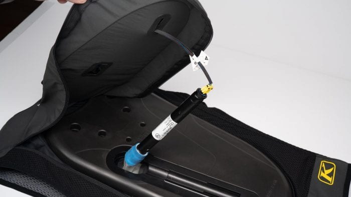

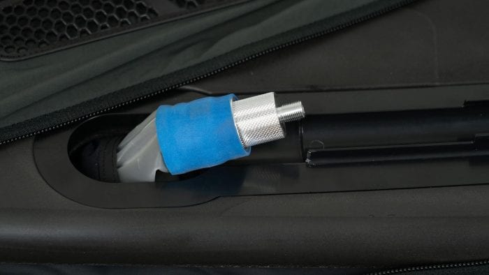

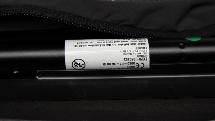

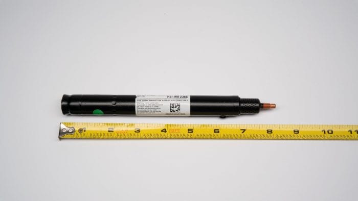

Speaking of the back, opening the rear panel reveals the back protector along with the gas cartridge and the attachment to the airbag itself (seen in blue). A wire is connected to the canister and runs up into the nylon flap where it connects to the In&Motion hardware. This can be disconnected from the cartridge so that the back can be fully opened.
View of Klim Ai-1 airbag vest back protector and argon gas cartridge Opening the rear panel reveals the CE Level 1 back protector and the argon gas cartridge
The cartridge fits into a clip embedded in the back protector itself. I like the design here as it keeps the hard metal tube on the side facing away from the body. It does, of course, make a portion of an otherwise pliable back protector rigid where the cartridge rests.

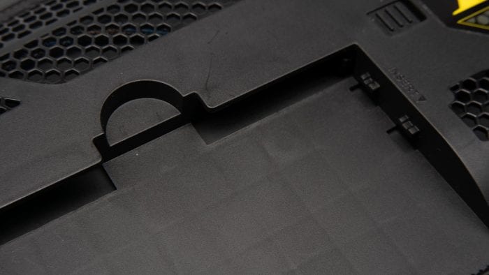

Overall, the Ai-1 is well constructed with straight and even seams throughout. The only area that concerns me is the “over protector” panel at the back where the electronics module plugs in. The “feel” of the box and the plastic in this area doesn’t feel the sturdiest.
Closeup logo of Klim Ai-1 airbag vest
Maybe it’s because the plastic is designed to be flexible rather than rigid, but it doesn’t give the impression of a finely crafted item. Installing and removing the electronics isn’t a very graceful operation which also detracts from the sense of build quality, however, it does stay secure once in place.
Does any of this prevent the vest from doing its job? Probably not, but good fit and finish can go a long way to improving confidence in a piece of protective equipment.

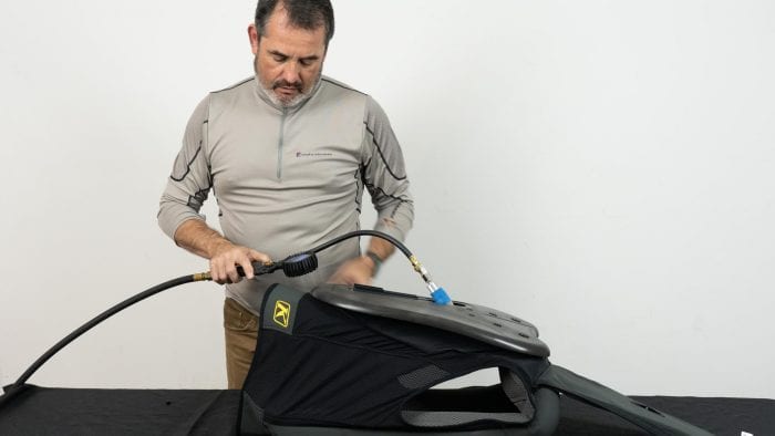

Below you can see what the vest looks like fully inflated from both the front and side (don’t look at the open flap hanging down on the back). There is excellent coverage of the front and very good coverage down the back. I would like to have seen a little more protection in the back closer to the tailbone as my Hit-Air MLV-C provides.
Front and side view of user wearing inflated Klim Ai-1 airbag vest Vest fully inflated showing the airbag coverage
Note: I used the Schrader valve attachment to inflate the vest to 5 psi in order to demonstrate how it looks fully deployed. I didn’t want to waste the $99.00 gas generator and frankly, there are a ton of videos out there of the vest being set off.
I really appreciate how much coverage there is around and behind the neck. This seems to be much more comprehensive and thicker than what some other “under the jacket” vests appear to offer. It should be noted that Klim states that one should not wear backpacks or other similar https://3.basecamp.com/3907575/items in conjunction with the Ai-1 as it can reduce/inhibit the performance of the vest.
Rear view of individual wearing an inflated Klim Ai-1 airbag vest Rear view of the inflated Ai-1 vest

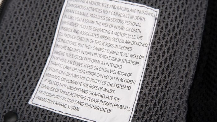

Interior label of Klim Ai-1 airbag vest

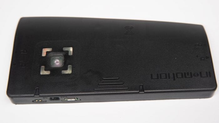

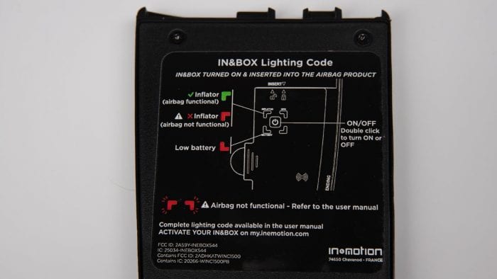

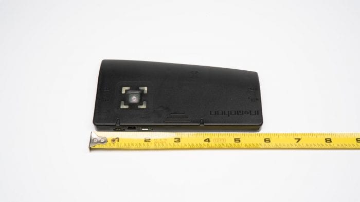

Before setting out on one’s first ride with the Ai-1, the electronic sensor package (referred to as the In&box ) needs to be set up and activated. Before doing any of this, it is recommended that the device be fully charged. A micro USB cable is provided in the box so it can be plugged into whatever USB outlet you have handy.
Front view of the In&box module In&box module

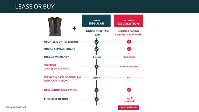

Yup, I said payment. In order to activate the In&box one has to pay for it. This can be done in three different ways. There is a month to month plan that runs $12.00 a month or one can save a little money and pay for the year at one time for $120.00 saving you $24.00 for the year. The other option is to purchase the In&box outright for $399.00.
Now before you stop reading, hang with me for a minute.
I think we’ve run into the most divisive aspect of the Ai-1 vest at this point. I get the idea of paying for the In&box, subscription or otherwise, might rub people the wrong way. Personally, I’m not that offended by it.
In&box lighting legend on back of module Light codes are labeled on the underside of the In&box
Yes, the vest costs $399.99 itself and now we’re paying additional fees to activate it? The fact is the overall cost is pretty much in line with the other electronically deployed options out there. The Dainese and Alpinestars latest street riding vests run $699.00 at the time of this writing.
Factor in other considerations like whether or not one has to send the vest to the manufacturer or dealer for inspection after a deployment, the cost of replacing a cartridge(s), and other costs, and I think the three main choices in these types of vests all come out to a similar cost.
I believe that costs are going to add up for any of the latest generation airbag vests, at least until they become more popular so demand can bring the price down. This latest generation is already several hundred dollars less than the early street oriented electronically activated airbag vests.
Schrader valve attachment for manual inflation of the Klim Ai-1 airbag vest Schrader valve attachment for manual inflation of the airbag for inspection
In my case, I chose to go with the $12.00 a month plan (full disclosure, I’m paying for the subscription myself). I did this since I didn’t know if I would want to keep the vest long term and this plan would allow me to easily drop the subscription if needed.
While not implemented in the United States market yet, there will be the option to suspend the service temporarily. For instance, if you live somewhere where it’s not reasonable to ride during the winter, you can stop paying for the service during that time. Once this option is available we’ll update this article with the details.
What’s Included​
So as not to reinvent the wheel, I have grabbed the graphic provided on Klim’s website and placed it below. I feel it makes the most sense to do the leasing option based on the features that come with that plan. For those that want to own the In&box outright, the option is there.
Leasing and purchase options for the In&box app

The device has both Bluetooth and wifi built-in allowing the In&box to be set up by a mobile device with the My In&box app installed. Once the app is installed one needs to pair the box with your device.

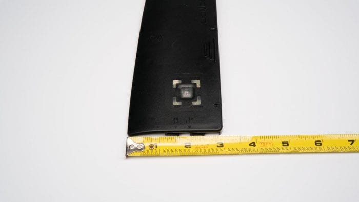

In&box and tape measurement In&box with tape measure for scale
Sometimes these setups are fussy but connecting the app to the box went very smoothly using my Google Pixel 4a Android phone (Android ver 11). I didn’t have any iOS devices on hand to test so Apple users may have a different experience.
In&Motion has simplified the setup through the use of QR codes and Barcodes which the app can read which reduces the typing required to perform the setup. There is a QR type code on the label for the In&box and the vest itself has a serial number with an accompanying barcode. The latter is located inside the left side internal opening so if you don’t see the label have a look inside to find it tucked in this space. You’ll also find a barcode on the gas cartridge.
Once connected, the mobile app displays information which includes the battery level, update status, and wifi network. The wifi is important as when set up properly, the In&box will have direct access to the In&Motion servers. This allows the box to download updates whenever it is turned on and near your network but it can also upload riding data.

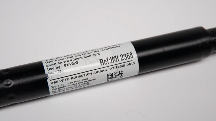

Should you be in the position of having set off the airbag, the vest will need to be inspected and the argon canister replaced. Thankfully one can do this without having to send the vest in to Klim or In&Motion assuming two factors.
  1. This is only the first or second time the airbag has been deployed. Once the airbag has deployed three times it needs to be returned to Klim to be inspected and reset.
  2. Testing the vest determines that the airbag is undamaged
Thankfully Klim provides a way for the owner to test the integrity of the airbag on their own. Along with a replacement argon canister ($99.00 USD) is a Schrader valve adapter. This can be used to manually inflate the vest and check that it still holds air.

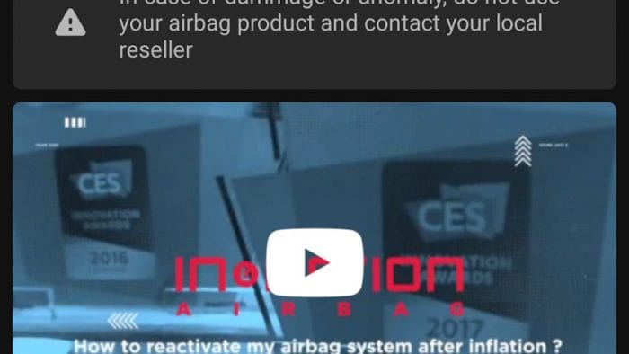

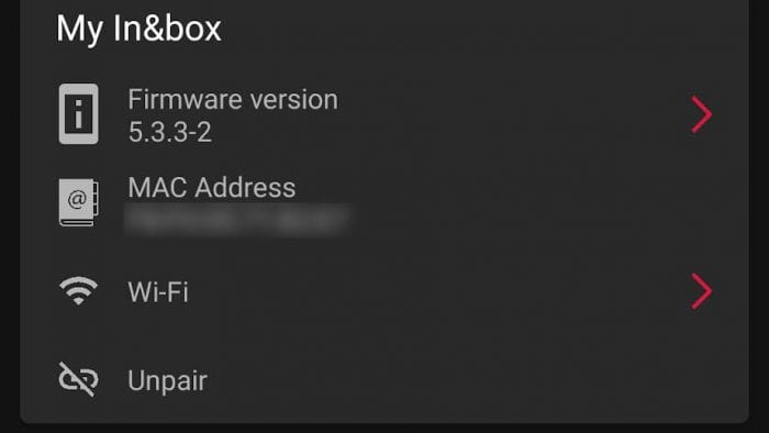

The mobile device app includes instructions and a video that demonstrates how to install the new argon cartridge. There is also the ability from this page of the app to scan the QR code on the canister to complete the installation and set up.
My In&box app firmware screen
Sharp-eyed readers may note that the instructions mention not to touch the blue connector with your fingers. This appears in the manual as well. I thought this was odd because I assumed they meant the large blue pipe/tubing connector into which the argon canister is threaded. After watching the video included in the app, I see they are referring to the blue connector for the electrical connection. This makes sense as in the video you can see the demonstrator clearly gripping the blue connector at the tubing.
Closeup of Klim Ai-1 Airbag Vest gas generated and airbag connection. Gas generator and airbag connection closeup
Armed with all this information one can easily remove and replace the gas cartridge, verify the integrity of the airbag, and register the new inflator with the system. All in all, this should take maybe fifteen minutes tops to be back in business and ready to ride assuming the airbag isn’t damaged.
After having been through three activations, the vest needs to be returned to Klim (or other authorized agents) for inspection and potential airbag replacement. The cost of the inspection is only the cost of shipping. If the vest needs repair of some kind Klim will let you know the cost.
Individual inflating the Klim Ai-1 Airbag Vest with air pump. Inflating the Ai-1 vest to 5 psi for fully inflated photo
Klim Ai-1 airbag vest mesh interior
