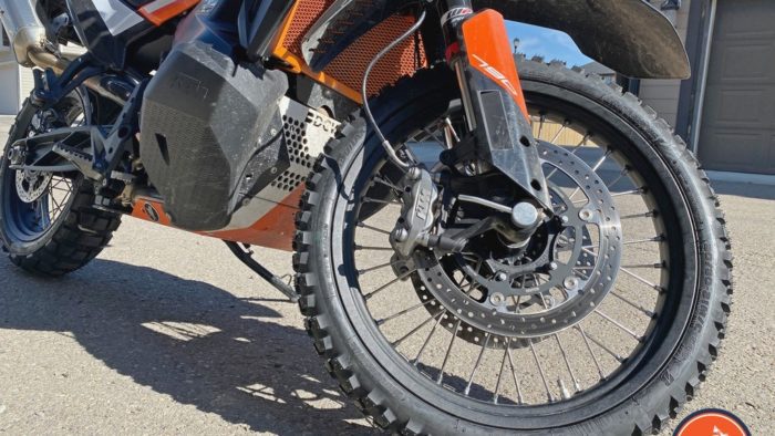

Bridgestone Battlax AdventureCross AX41 tires on KTM 790 Adventure bike
I purchased these tires myself for this review and didn’t receive any assistance or influence from Bridgestone.

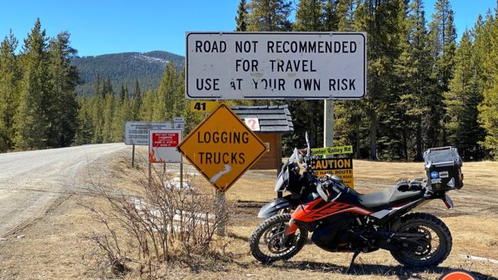

Three motorcycles by frozen mountain lake near Canmore in Alberta
The off-road environment was primarily gravel roads of varying hardness and depth, plus rocky hills, soft and hard dirt trails, and a healthy dose of both shallow and deep mud in the foothills and backcountry of British Columbia and Alberta, Canada.

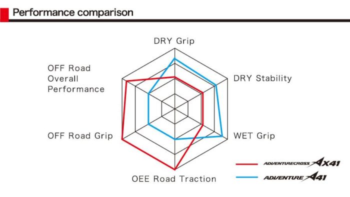

Performance comparison chart for the Bridgestone AdventureCross AX41 tirePhoto from Bridgestone.
Take a look at the diagram above (from the Bridgestone website). The red line confirms that even Bridgestone agrees the AX41 isn’t the best choice for wet road grip when compared to other tires like the Bridgestone Battlax A41 (blue line). But you give up a lot of off-road performance if you choose to go with the A41, so it’s a bit of a trade-off.
I don’t agree with their estimation of the dry stability on pavement being equal with wet (if I’m reading the chart/diagram correctly), but who knows what motorcycle they tested the tires on?

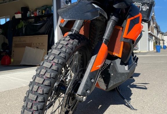

KTM 790 Adventure parked by logging road
Gravel Riding​
On hard-packed gravel and dirt roads the AX41 is about as good as any other tire I’ve ridden on (TKC80, Anlas Capra X, Mitas E09, E10, Motoz TA) when it comes to traction. This is the AX41’s true happy place, despite how well it performs on dry asphalt. It excels on dirt and hard pack, making me want to twist the throttle hard to spin the rear wheel with reckless abandon.

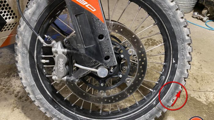

The sidewall of the front tire did sustain a slash (that ended my testing) from some smaller and very pointy shards of granite I rode through on a trip in British Columbia on the Columbia and Western Railway Trail.
Sidewall slash on front Bridgestone Battlax AdventureCross AX41 tire
I also sustained a noticeable dent in my front rim on the same trip. The sidewalls aren’t nearly as stiff as other more aggressive tires. It’s a compromise made by Bridgestone to get better on-road performance, I’m sure.

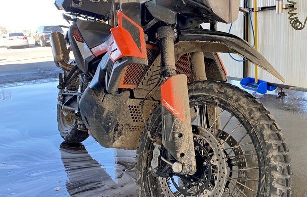

Mud handling inspired adequate confidence, but when the trail turned into slippery wet clay I found the AX41’s limits of traction—as has been the case with most any adventure tire I’ve used.
However, it came about differently with the AX41 than with others. I noticed the treads don’t clear themselves of sticky muck as well as say, the Motoz TAs did, which leads to a bit more sliding and spinning than with more aggressive tires. Again, the softer sidewall and shorter lugs thereon don’t bite into wet muck the way more aggressive tires do.
Mud buildup in treads of Bridgestone Battlax AdventureCross AX41 tireMud doesn’t clear easily from the treads of the AX41.
Still, this tire was very good overall in all off-road conditions for me and the 790.

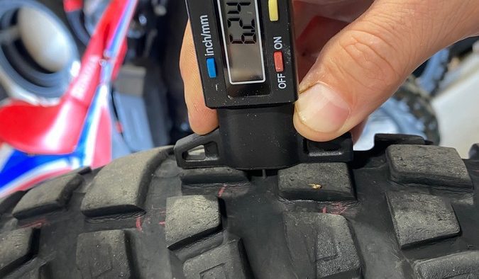

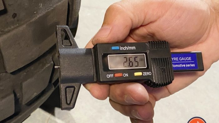

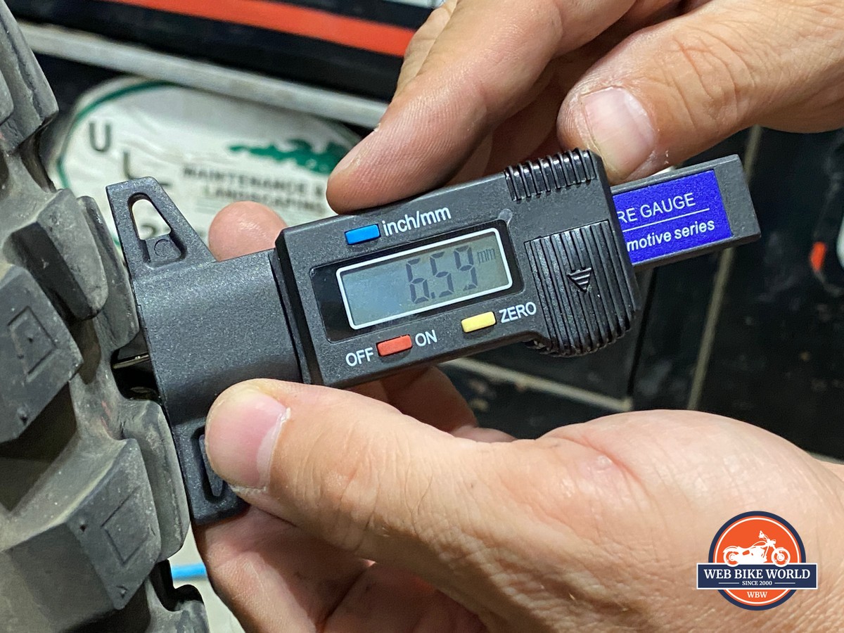

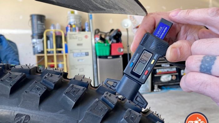

Tread Measurements​
Bridgestone Battlax AdventureCross AX41 front tire being measured in garageBrand New Front Tire Tread Depth measurement: 7.9 mm.
Bridgestone Battlax AdventureCross AX41 rear tire being measured in garageBrand New Rear Tire Tread Depth measurement: 9 mm.

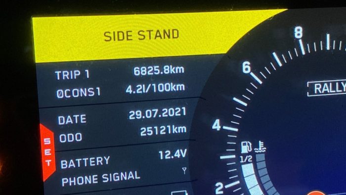

After only 6825 fun-filled kilometers, my rear AX41 was showing only 2.6mm of tread remaining and I made the difficult decision to pull it off the bike before heading out on another adventure.
Trip meter reading on KTM 790 Adventure after rear Bridgestone AX41 tire wore out
That’s only 4240 miles for those who prefer imperial digits. We can all agree that’s an early exit, which equates to far less than half the miles I racked up with the Motoz TAs.

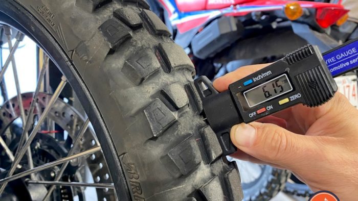

Front vs. Rear Tire​
Ditching the AX41 rear was the right decision. As I mentioned earlier, on my ensuing trip to BC, some sharp rocks I encountered left a menacing sidewall slash in the front tire, which cut short this review. My total accrued mileage on the front AX41 was a respectable 8759 kilometers (5442 miles) with 6.1mm of tread remaining.
Measuring front Bridgestone Battlax AdventureCross AX41 Tire

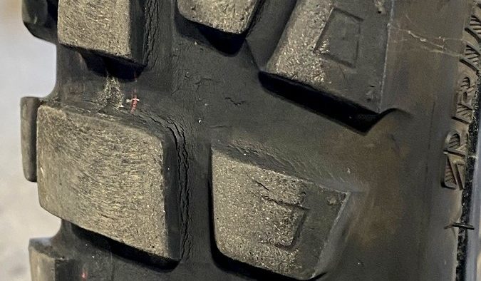

However, I noticed cracks were developing around some of the tread blocks by this point, which may have led to delamination as time went on. See the photo below.
Cracks around the tread blocks of Bridgestone AX41 front tire after 8700kms
Barring sidewall cuts or delamination failures, I suspect the front AX41 should achieve at least 10,000 to 12,000kms (6000-7400 miles) before needing to be relieved of duty. Not bad, and about a normal ratio of front to rear tire life, I suppose.

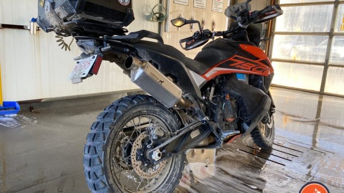

My testing of the front AX41 might be a little tainted, thanks to a gaffe by a local motorcycle shop technician who installed the tire backwards on my 790. See the photo below.
Front AX41 tire installed backwards on KTM 790 Adventure
I failed to notice until I’d ridden 800 miles and had this corrected. I’ll say this much with absolute certainty: don’t disregard the directional arrow on these tires or you’ll regret it greatly.
With the tread blocks going the wrong way, the AX41 front tire is an absolute nightmare anywhere off-road or in deeper gravel. It was so unstable that I felt like I was a brand new rider again while trying to keep the bike rubber side down.
To state the obvious: directional arrows matter!
